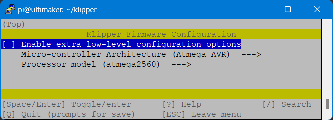

make menuconfig
If this is a fresh klipper install you will likely find the defaults of Atmega AVR and atmega2560, that is what you need.
Hit Q and save then enter make to compile the firmware.
