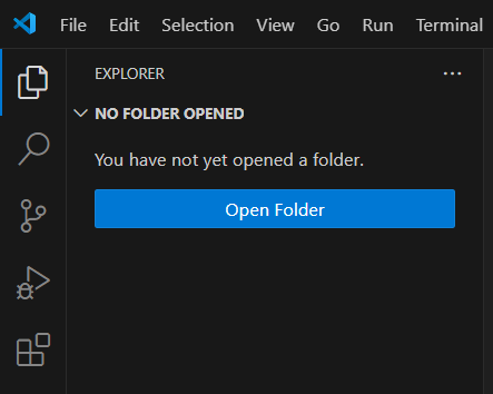

Install VSCode for your platform from here - https://code.visualstudio.com/Download

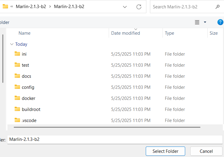

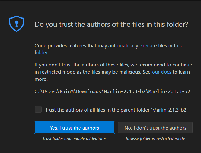

We will need to install PlatformIO but as the Marlin guide points out we will be prompted to the first time we open a Marlin firmware project folder. Download and unzip your desired version which for most of our guides is currently the upcoming 2.1.3 (beta or the bugfix fork) or in some cases 2.1.2.5 from here https://marlinfw.org/meta/download/

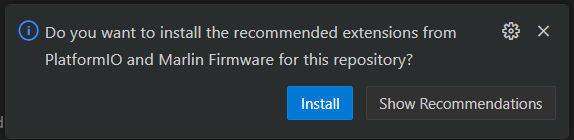

In the bottom right you will be prompted to install PlatformIO

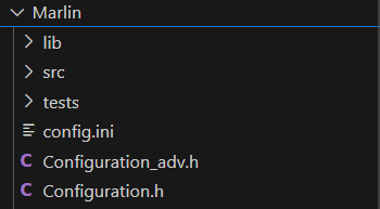

Click on the explorer icon in the top left and you will spend the majority of your time editing the 2 configuration files found in the Marlin folder:
